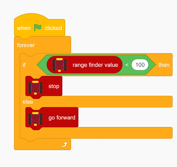

  • Single condition → robot stopped when obstacle was near
  • Distance sensor → measured distance and triggered stop
You may show them the code that they made in the previous session.

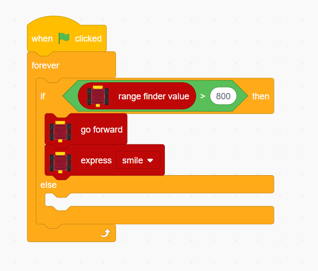

  1. The normal behaviour of the robot when nothing is front of it, it should smile and move forward. So let’s just start with that:
Encourage students to experiment with different values and decide which value indicates that the path is clear

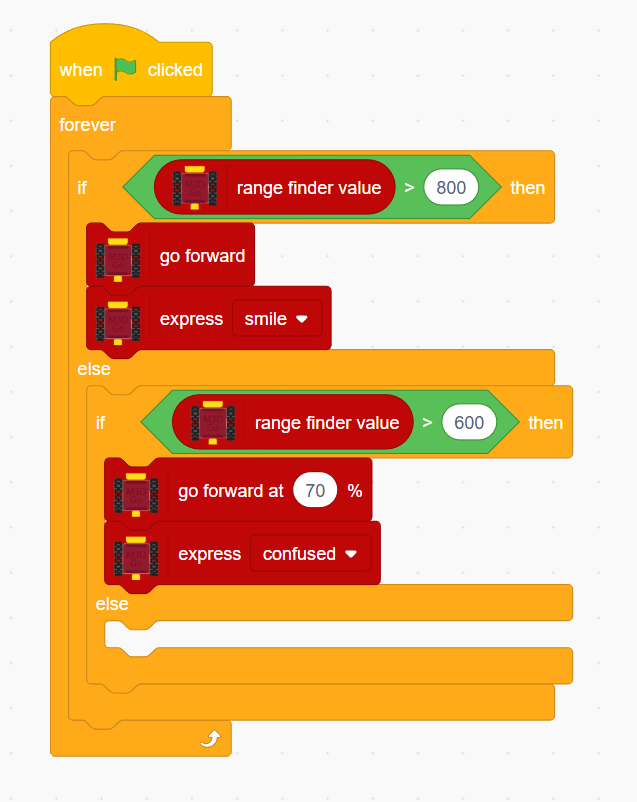

  1. Now that the normal behaviour is coded, the next condition would be that there is something in the robot’s path, but it is far away. That means, the sensor value is lower than the one we used before which indicated a clear path, but it is still not that low. For example, if the value 800 indicates a clear path, then 600 could indicate an object far away.
At this point, you also have to the logic of how we are using these loops and how they work. The reason we have coded the next condition in the “else” part of the first loop is because the second condition should only be checked if the first isn’t true.
If the path is clear, it should only move forward and not execute any other condition.
We can also understand this by looking at our code. The first condition is true when the value is greater than 800 while the second will be true if the value is greater than 600.
Now, if both conditions are checked simultaneously for a value, say 900, then both conditions will be satisfied and two different movement instructions will be executed at the same time. This will create confusion for the robot. So, we have to design our code in a way that only one condition is checked at a time.

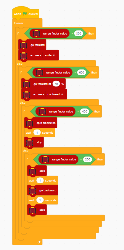

  1. Repeat the same process to code the next conditions.
Each condition will be coded in the else part of the previous condition block.
Encourage students to code as many behaviours as possible by adding more if-else blocks
