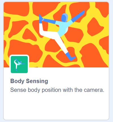

  • Laptops with Scratch + Body Sensing and Face Sensing extensions enabled

  • Enable Body Sensing UI and show live body point coordinates.
  • Ask one volunteer to perform small gestures (move left hand and right hand). Students observe which x/y numbers change.

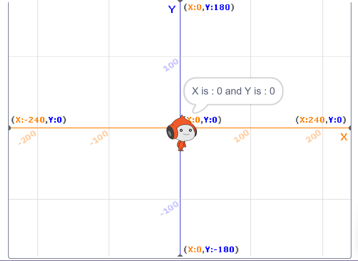

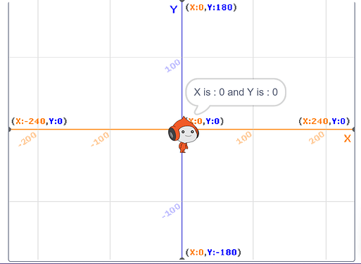

“Now, we need to convert these coordinates into actions for the robot. Last time, we divided the screen into four parts or quadrants as follows:”
  • Quadrant I: x+, y+ (Top-right)
  • Quadrant II: x-, y+ (Top-left)
  • Quadrant III: x-, y- (Bottom-left)
  • Quadrant IV: x+, y- (Bottom-right)
You may write/show this on the board/screen for recall.
“We can use the same technique today as well. But, since we are tracking multiple body parts, it might get complex to handle multiple coordinates. But, we can use that to our advantage as well.”

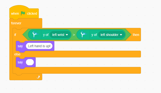

“For example, if we want to check if the left hand is up, we can check in which quadrant the hand actually is. Another way of doing it is, we check whether it’s position is higher than that of left shoulder. Makes sense right?”

“How will you avoid accidental triggers? Can you add a small wait or require a gesture to be held for 0.5 seconds?”

  1. Steady Walker: robot moves forward only while the right hand remains above shoulder level. Measure how long they can hold it steadily.
