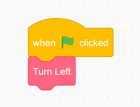

Continue with “Turn Left” to make the robot turn, saying,
“When we use this block, the robot will rotate to the left.”

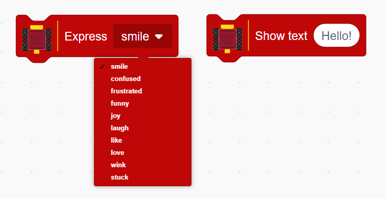

Once that’s done, demonstrate how to add an emoji using the “Express” block and a message with the “Show Text” block. Say,
“Now, let’s make our robot smile with an emoji and display a message like ‘I’m ready to go!’ using the ‘Express’ and ‘Show Text’ blocks.”

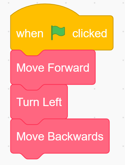

Start with a simple program: move the robot forward, make it rotate, and then stop. Guide students through each step, saying,
“Let’s start by making the robot go forward, then turn, and move back.”

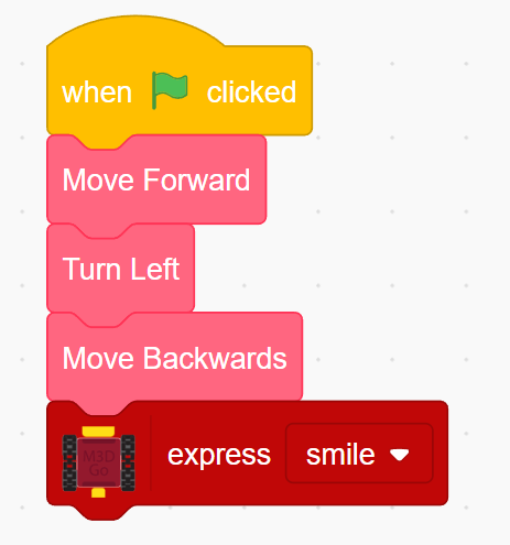

Encourage students to add an emoji and a short message, such as a smiley face and “Hello!” to personalize the robot’s actions. You may say,
“Now let’s add a smiley face emoji to make the program more fun!”

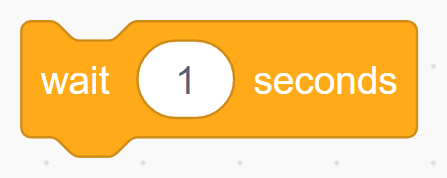

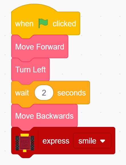

Use the “Wait” block to create a short pause between movements or actions. For example,
“We can use the ‘Wait’ block to give the robot a short pause before it moves again.”
You may demonstrate this with a simple example like,
“Let’s wait for 2 seconds before the robot moves backwards.”
