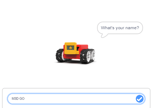

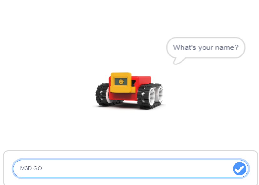

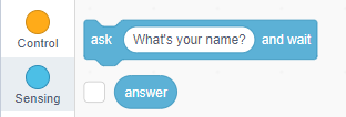

  1. “Ask ___ and wait” stores the response in a variable called “answer.”
Let students experiment with these pre-existing variables:
“Now, let’s ask the robot a question and see how the ‘answer’ variable works.”
Show them how they can check the value stored in the variable by dragging it from the list of blocks and clicking on it.

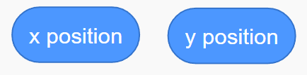

  1. “Position x” and “position y” tell the horizontal and vertical position of the sprite.
Note that the students don’t confuse the position of the actual robot with the position of the sprite. These code blocks tell us the position of the sprite inside the gamepad.

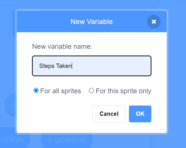

3. Creating and Using Custom Variables (15 minutes)
Students will learn how to create their own variables in Scratch, store information in them, and adjust values.
  1. Introduce the “Make a Variable” option in Scratch. Show them how to create a new variable:
“Let’s say we want to keep track of how many steps our robot takes. We can make a new variable called ‘Steps Taken’ and store that information.”
Highlight the importance of choosing the right name for the variable so that when the student looks at it, it can remind them of the value that is stored in it.

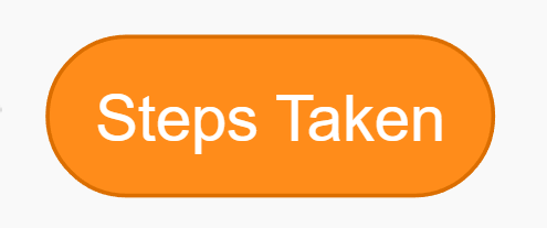

After the variable is created, it will look like this:
Encourage them to identify how all variables are “pill-shaped” blocks. This will help them identify variables from other blocks quickly when creating larger code blocks.

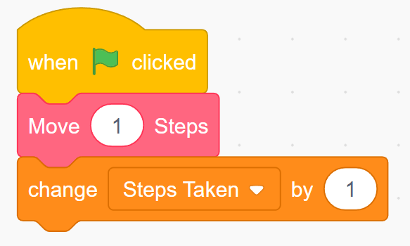

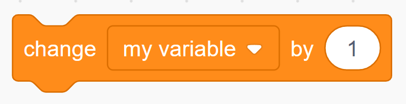

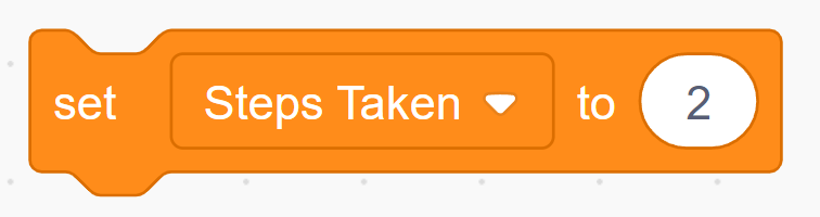

  1. Demonstrate how to use variable blocks like:
Help students create their own variables and guide them in understanding how the robot uses these variables to store changing information. Help them understand the difference between changing the value and incrementing the value of the variable.

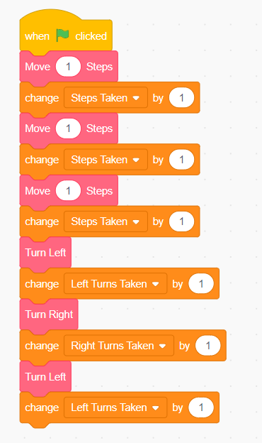

  • Ask students to create a variable called “Steps Taken” and have it increase each time the robot moves:
“Every time the robot takes a step, we’ll increase the value of ‘Steps Taken’ by 1. Let’s see how far it travels!”
  • Let them program the robot to move forward, and after each movement, they’ll use the “Change [Steps Taken] by 1” block to update the variable.
  • Students can also track time using the “Timer” variable to see how long it takes for the robot to reach a destination.
  • Encourage students to build larger coding blocks where they store different values e.g. steps taken, left turns taken, right turns taken etc.

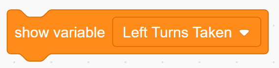

Ask them to check if the variable is showing the correct number of steps when the movement ends by using the “Show Variable” block:
Encourage students to observe how the robot’s behavior changes when they adjust the variables. Guide them to experiment with combining variables like distance and time to see how fast the robot moves over a given distance.
