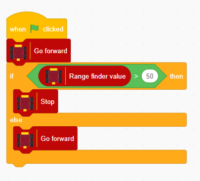

  1. Coding the Condition:
    Guide students to use the “If-Then” block to create a condition where the robot stops when the distance sensor detects an obstacle within a certain range:
“If the sensor detects an obstacle closer than 10 cm, then stop. Otherwise, keep moving forward.”
Help them create a simple code that looks like this:

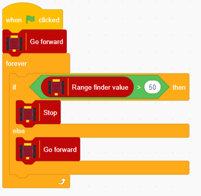

  1. Updating the Code:
Once they do, ask them to drag it out of the blocks and use it in their code. Help them in modifying their code to include a loop for continuous checking:
