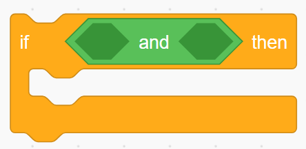

  2. Show how they can check two conditions at the same time using the “and” block in Scratch. You can say:
“Since there are two sensors, we need to be able to check two conditions at the same time. It’s just like how we checked a single condition with one additional block called the “And” block:”
{D998D562-E19D-4377-B646-E9AD175D4734}
  • Encourage them to notice how the shape on both ends of the block is the same as the one used for conditions. This tells us that this block is also used to check conditions. You can say:
“This can be used with If-then block and it works just as it looks and sounds. If first condition and second condition both are satisfied, then the robot will perform the action. If they are not, it will not do anything.”

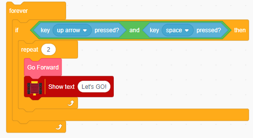

Demonstrate how this code block will make the robot repeat the movement only if both keys are pressed which means both conditions are true.
  • Encourage them to use the and block with different types of conditions. You may give them some problems such as:
  • Compare 2 numbers in both conditions and if the left one is greater than the right one in both conditions, the robot will start spinning left. If the right one in both conditions is greater, the robot will start spinning right.
  • Check if both up and down arrow are pressed. If they are, the robot will show confused face. If one of they keys is pressed, the robot will say “Let’s Go!”

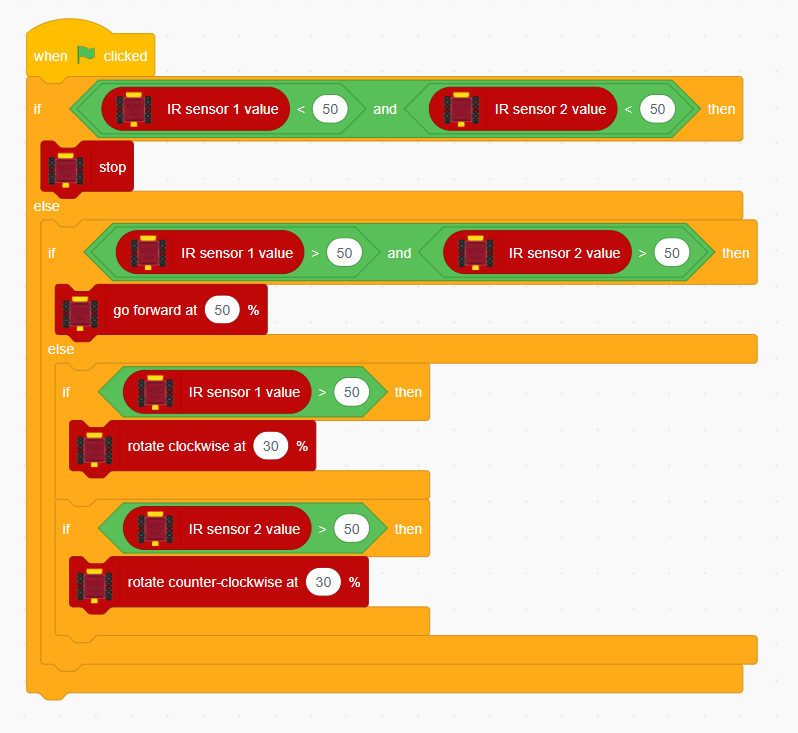

  1. Walk them through the logic of how to code the robot to follow then line and stay on the line as follows:
  • If both sensor readings are above a certain value (IR Sensor 1 value > Normal value and IR Sensor 2 value > Normal value at the same time) meaning the robot is on the line, the robot should forward.**
[Note that the normal value is what the sensor reads on a white sheet of paper in the absence of any other colors.]
  • If one sensor reading is high and the other is low (IR Sensor 1 value > Normal value and IR Sensor 2 value = Normal value or vice versa), the robot will rotate to stay on the line.
  • If neither sensor detects the line (IR Sensor 1 value = Normal value and IR Sensor 1 value = Normal value), the robot will stop.**
  1. Guide students to code their robot’s movements based on these sensor inputs. Explain how the robot can adjust its path based on what the sensor detects.
  2. Encourage students to test their code on the pre-drawn black line and adjust as needed.
Their final code should look like this:
