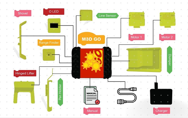

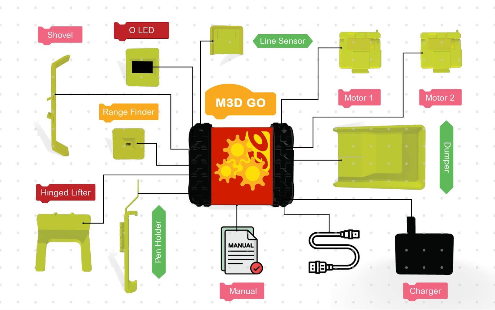

When you open the M3D Go kit, you will find the M3D Go Robot, it’s charger and the following attachments inside:
- OLED Screen
- Distance Sensor
- Line Sensor
- Servo Motor with mounting points which can be used with the following parts:
- Dumper
- Pen Holder
- Dozer
- Forklift
- Lego extension attachment
1. Getting Familiar with the Attachments:
All the included attachments connect directly to the robot and have plug-and-play connectors. You can just plug the attachment into any port and it will start working. To use the robot and the attachments, you will have to set up the robot and connect it to a computer/laptop.

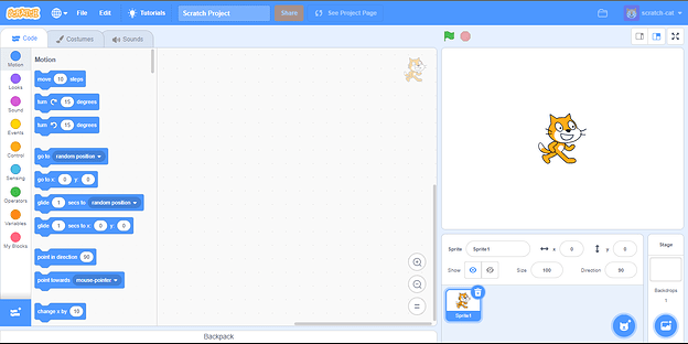

3. Introduction to Scratch:
Once the site has loaded, you should have the following screen in front of you:

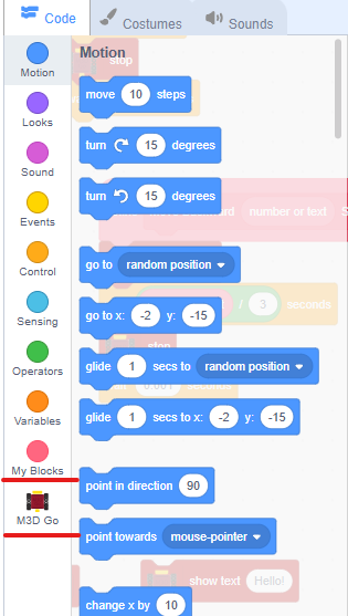

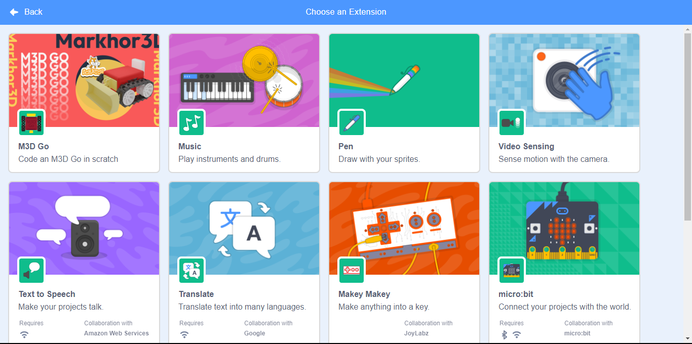

Click on the icon on the bottom left corner which has some blocks and a plus sign on it. It will take you the extensions page where you can add the M3D Go extension:

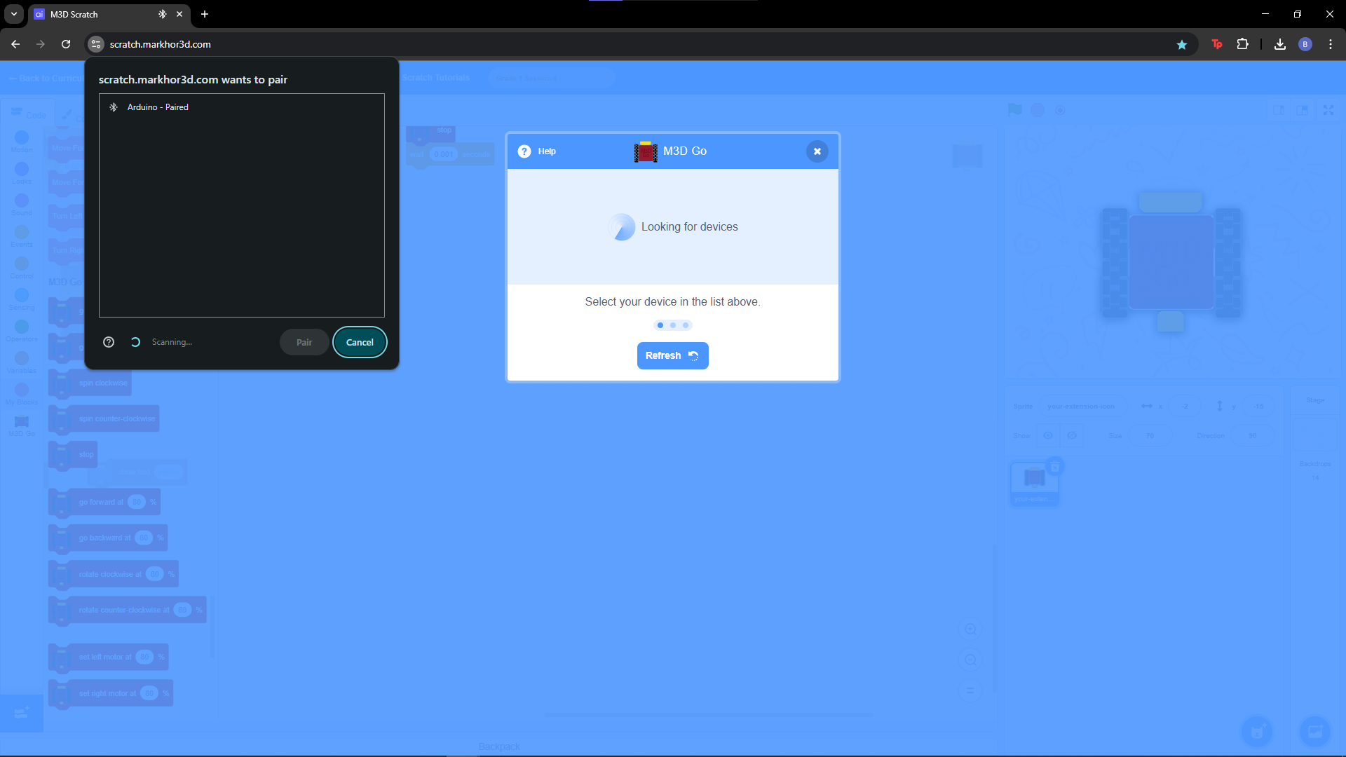

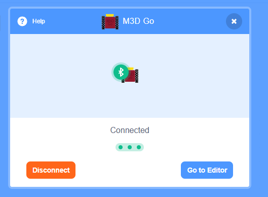

Once you click on it, a pop-up dialog should appear which will show your device name. Select your device name and then click on pair button.
Once it connects, you should get a confirmation message:

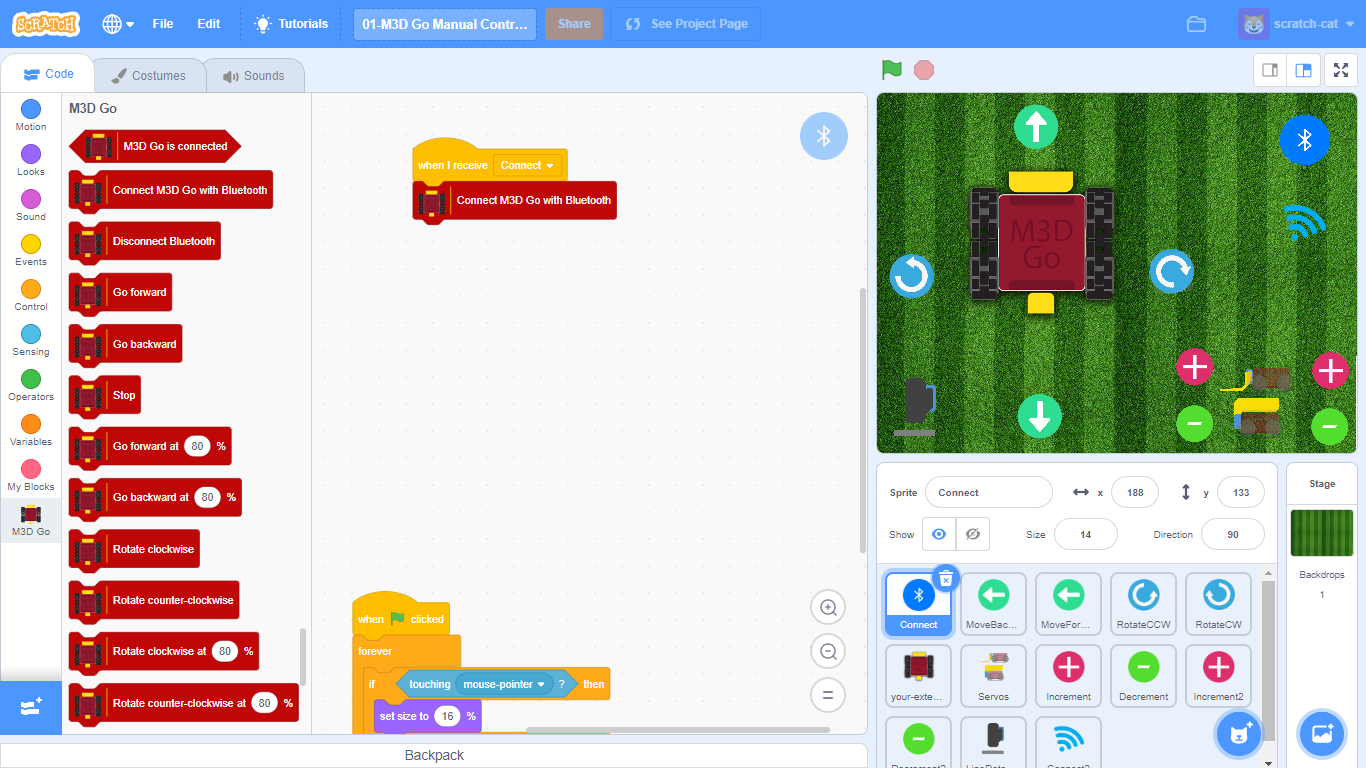

After downloading the file, you can load it in your scratch environment running on your web browser and you should get this scratch interface:
If the dialog box does not appear, you can connect it manually as follows:

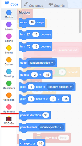

Scroll down to M3D GO blocks in list to your left:

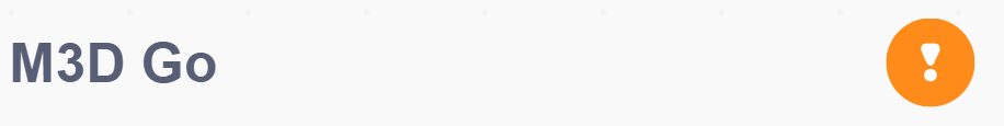

You should see your bot along with a yellow button in front of it.
Click on it to connect your bot to connect your bot to the computer.

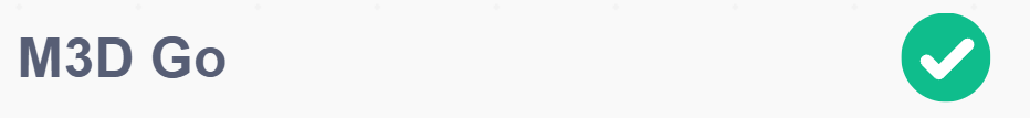

It should turn green once the bot is successfully connected:

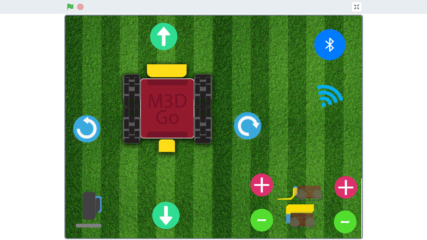

Once connected, you can use the on-screen control pad to control the robot’s movement:
You can use your keyboard buttons to control the movement of the robot as well:
- Arrow keys for navigation
- Motor control keys: Q/A for motor 1 and W/S for motor 2

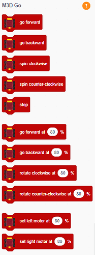

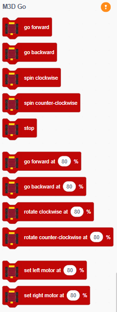

Movement Blocks:
- Go forward/backward
- Spin Clockwise/Counterclockwise
- Stop
- Go Forward/Backward at __ % for movement at specific speeds
- Rotate Clockwise/Counterclockwise for rotation at specific speeds
- Set left/right motor at __ % for individual motor control)
