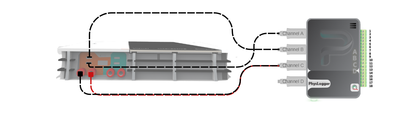

Another common mistake is choosing the wrong channel when connecting the sensor. Make sure you have selected the correct channel when you specify the quantity you are trying to measure. You can always refer to the following diagram which can also be found in the MeasureLab Setup Guide:

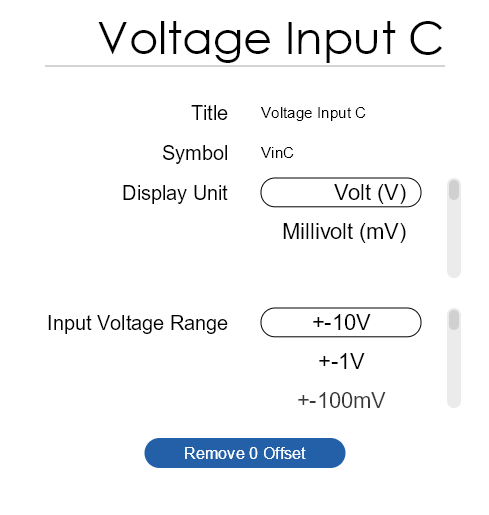

If you have chosen an incorrect range or would like to change the range during the experiment, you can do so using the “Quantities Menu”. Open the menu and click on the quantity whose range you would like to change. You will get a pop-up menu where you can reselect the range. For example, the menu for changing the range of voltage looks like this:
