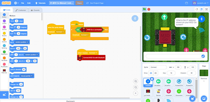

  • Scratch app running on a projector for better visual aid.
  • Game pad program of scratch of the “M3D Go” next to the on-screen gamepad. (See Figure 3.2)

2. Hands-On Exploration with the Gamepad and Scratch Environment (15 minutes)
Students will get familiar with controlling the robot using the on-screen gamepad in Scratch, but first, they’ll explore the Scratch environment itself to understand how it all fits together. This helps them get a broader sense of the coding platform before jumping into robot controls.
  • Before diving into the gamepad, guide students to explore the Scratch environment. You may say:
“Before we start controlling the robot, let’s look around Scratch! This is where we’ll build our code. See all those blocks? We’ll stack them together, like building with Legos, to make our robot do different things.”

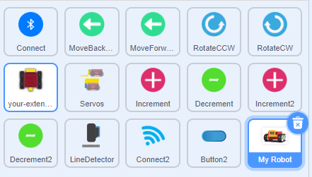

  • Introduce them to the Sprites:
“Each sprite is like a different part of our program. For example, if you look at the bottom-right corner, you’ll see ‘My Robot.’ That sprite controls the robot. It’s kind of like how the Bluetooth button on your phone helps connect it to other devices. Here, the robot sprite helps connect us to the robot’s actions.”
Let them hover over different blocks and sprites in Scratch, encouraging them to explore how everything fits together:
“See how every block has a different shape? That tells us where it can fit in our code. Let’s play around for a minute to see what you can find!”
The understanding of the function of these blocks is not necessary here. It is just so that students can grasp the idea of how different blocks fit with each other.

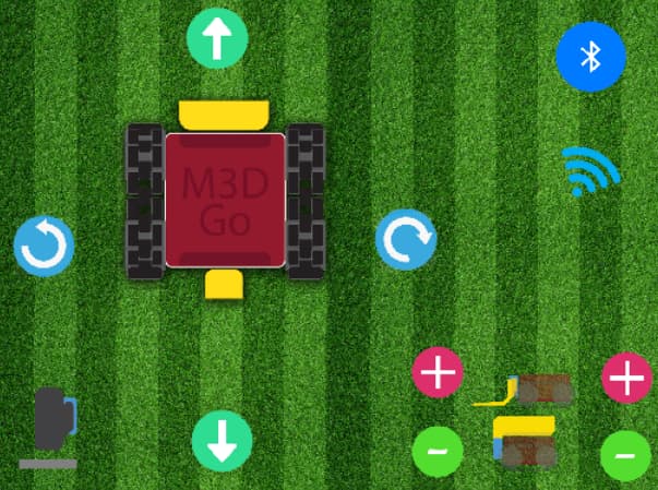

  • After exploring the Scratch interface, guide the students to the gamepad program.
  • Ask them to move their mouse over the digital gamepad and press buttons to see how the robot moves forward, backward, and turns in the animation.
    You may say:
“This is just like using a remote control for a toy car, but instead of physical buttons, you’ll use these controls on the screen.”
  • Encourage students to explore different movements:
“What happens when you press the forward button? Can you get the robot to turn right?”
Let them experiment by navigating the robot around small obstacles set up in the room.
  • Explain that the robot’s movements are powered by the blocks they’ll soon learn to control:
“Everything you’re doing with the gamepad now, we’ll soon be able to do with our coding blocks. Isn’t that cool?”

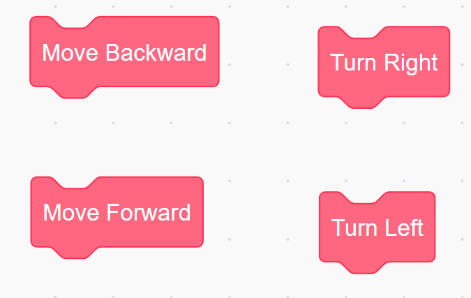

3. Introduction to Movement Blocks (15 minutes)
Introduce basic movement blocks in Scratch, such as “Move Forward” and “Turn Left/Right”. Students will see how these blocks replace the gamepad controls and allow them to write code to control the robot.

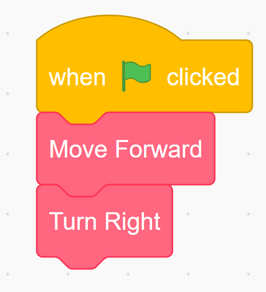

  • Show the students how to use the “When Green Flag Clicked” block and explain how it starts as the Go signal for the robot.
  • They can connect it to movement blocks like “Move Forward” and “Turn Left”.
  • Demonstrate how they can drag and drop blocks into the coding space and build simple sequences.

“Instead of using the gamepad, now we’ll use these blocks to tell the robot where to go. You can make it move forward, turn, or go backward—just like you did before, but now with coding blocks!”
  • Let students experiment by creating their own sequences of movements. Encourage them to try different combinations to move the robot in various directions.
Guide students through using the movement blocks, showing how they can combine them for more complex actions. Offer help as needed, but encourage students to explore and figure out how to create movement patterns.
