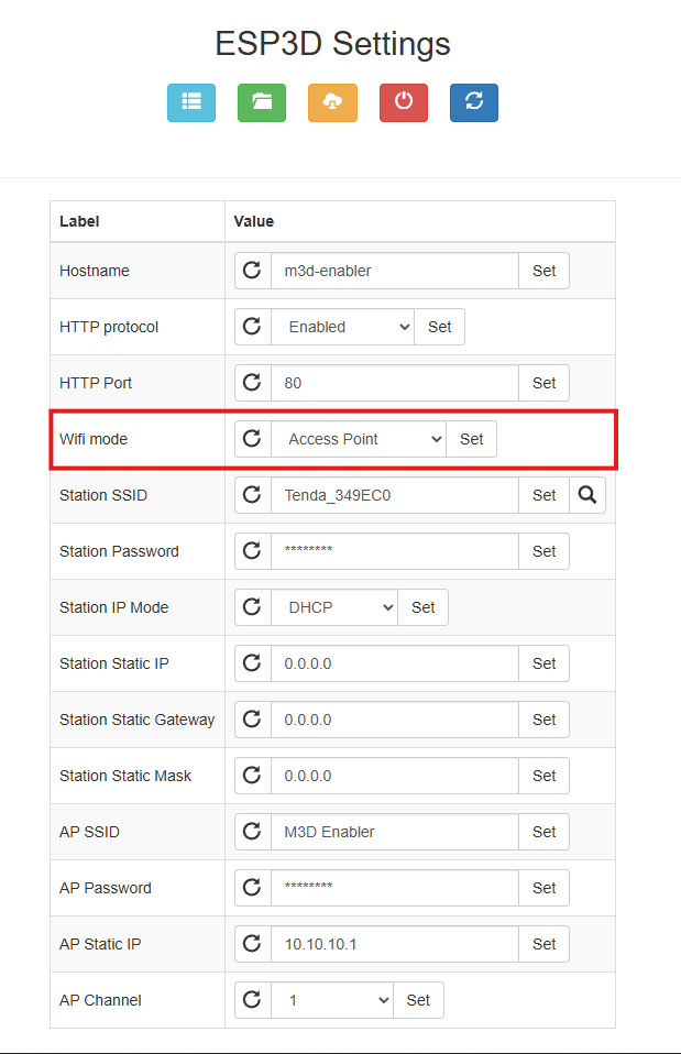

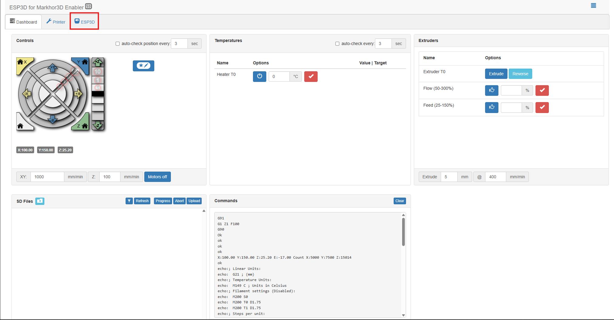

To do so, first connect your computer/laptop to your printer. Once connected, go to the D8500’s Web Utility:
http://m3d-enabler.local/
Once on the Web Utility page, navigate to the ESP32 section on the top left menu.
On this page, you should be able to see an option named “Wifi Mode”:

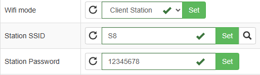

Switch this mode to Client Station and click the set button next to it. The option should turn green.
Screenshot 2026-01-13 162308

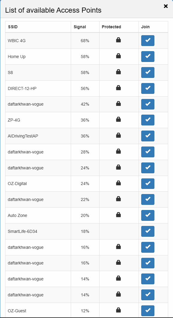

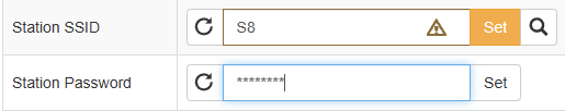

Now, click on the search button next to the Station SSID menu to search for your home WiFi network:
Screenshot 2026-01-13 162322
You will be able to see a list of available networks:
Select your desired network from the list. Once selected, enter the password of your WiFi network in the Station Password section:
Once done, click on the set button next to it. All the options should turn green.
Your printer should now automatically connect to your WiFi network whenever it is powered on.
