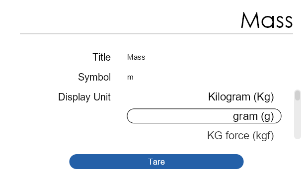

The most common problem you may encounter with load cell is that it’s resting position is not 0 when you start taking your measurement.
This can be simply fixed using the tare button in the “Quantities Menu”. Just open the menu and click on the quantity named “Mass”. You will see a button in the sub-menu named “Tare.”
Just press it and return to your Live Plot. This will reset the level to 0, just like in any load cell.
