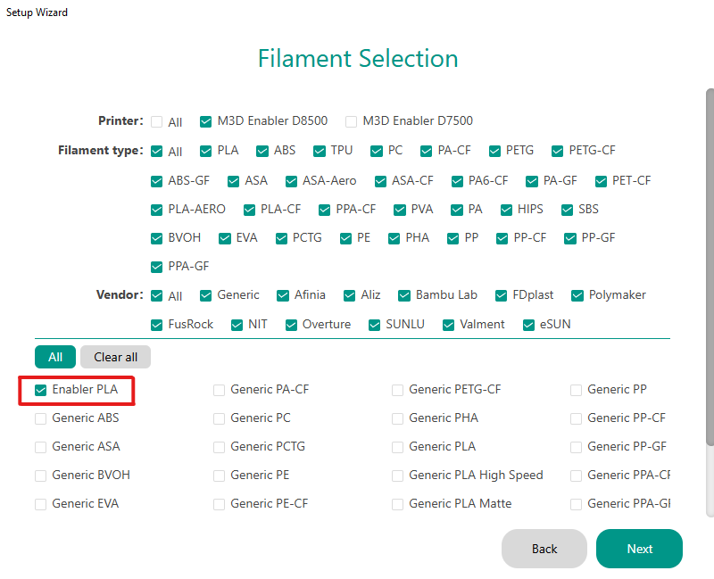

5.In the next menu, select the following options in the Filament Selection as shown in the picture:
6.Next you will get prompt to enable “Stealth Mode” and install “Bambu Network Plug-in”
  1. You can just skip them by clicking Next without checking the tick-box.
