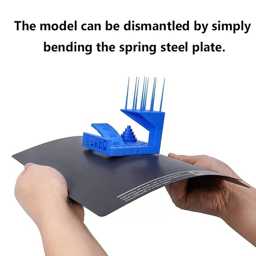

4. Removing Prints
  • Standard prints: Detach the flexible plate from the bed and bend it gently back and forth to release the print.
:warning: Warning: Do not bend the plate excessively, as this may cause permanent deformation.
  • Thin prints: Use a thin tool (e.g., tweezers) to carefully lift the print.
    • (Illustrations will be added to show safe hand placement and the right amount of force.)
  • Before reattaching the plate, ensure the bed is clean of debris. Even small particles can throw off bed levelling.
  • If prints start showing irregularities, run the bed leveling process again.
